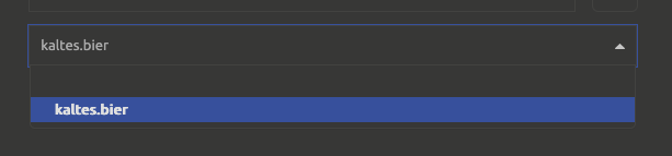

Current behaviour:
  • When a user manually adds a value (e.g. a custom username), it appears in the dropdown.
  • If the dropdown is collapsed, the value is highlighted in blue — suggesting it is selected.

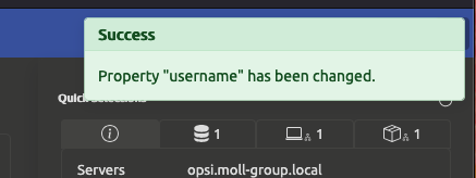

  • Clicking this value again triggers a "value changed successfully" message.
  • However, the value is not changed, but deleted — without confirmation or any clear visual hint that the action removes the value.
This is confusing and unintuitive, especially since success feedback implies a valid change, not a removal.

Example images
Bildschirmfoto 2025-06-11 um 15.39.35.png (7.42 KiB) 19657 mal betrachtet
Bildschirmfoto 2025-06-11 um 15.43.31.png (6.4 KiB) 19657 mal betrachtet
Bildschirmfoto 2025-06-11 um 15.40.09.png (17.49 KiB) 19657 mal betrachtet
