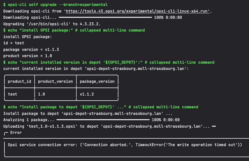

I'm sorry, but the self upgrade didn't solved the write timeout issue.
$ opsi-cli self upgrade --branch=experimental
Downloading opsi-cli from 'https://tools.43.opsi.org/experimental/opsi-cli-linux-x64.run'.
Downloading opsi-cli... ━━━━━━━━━━━━━━━━━━━━━━━━━━━━━━━━━━━━━━━━ 100% 0:00:00
Upgrading '/usr/bin/opsi-cli' to 4.3.23.2.
$ echo "install OPSI package:" # collapsed multi-line command
id = test
package version = v1.1.3
product version = 1.0
$ echo "current installed version in depot '${OPSI_DEPOT}':" # collapsed multi-line command
current installed version in depot 'opsi-depot-strasbourg.moll-strassbourg.lan':
│ product_id │ product_version │ package_version │
│ test       │ 1.0             │ v1.1.2          │
$ echo "Install package to depot '${OPSI_DEPOT}' ..." # collapsed multi-line command
Install package to depot 'opsi-depot-strasbourg.moll-strassbourg.lan' ...
Analyzing 1 package... ━━━━━━━━━━━━━━━━━━━━━━━━━━━━━━━━━━━━━━━━ 100% 0:00:00
Uploading 'test_1.0-v1.1.3.opsi' to depot 'opsi-depot-strasbourg.moll-strassbourg.lan'... ━╸                                         4% 0:00:02
╭─ Error─╮
│ Opsi service connection error: ('Connection aborted.', TimeoutError('The write operation timed out'))│

Beiträge: 2235
Re: Connection Timeout for opsi-cli package install
Sorry, more difficult to fix than expected.
Please try version 4.3.23.3 (experimental repo).

Thank you very much.
The latest version seems to be working.
