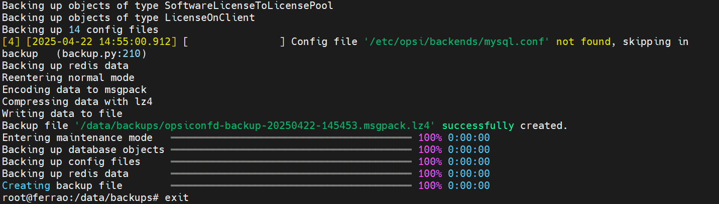

I ran the backup command inside the Docker container, but I got this message:
Config file '/etc/opsi/backends/mysql.conf' not found, skipping in backup
Backup file '/data/backups/opsiconfd-backup-20250422-145453.msgpack.lz4' successfully created.
Entering maintenance mode   ━━━━━━━━━━━━━━━━━━━━━━━━━━━━━━━━━━━━━━━━ 100% 0:00:00
Backing up database objects ━━━━━━━━━━━━━━━━━━━━━━━━━━━━━━━━━━━━━━━━ 100% 0:00:00
Backing up config files     ━━━━━━━━━━━━━━━━━━━━━━━━━━━━━━━━━━━━━━━━ 100% 0:00:00
Backing up redis data       ━━━━━━━━━━━━━━━━━━━━━━━━━━━━━━━━━━━━━━━━ 100% 0:00:00
Creating backup file        ━━━━━━━━━━━━━━━━━━━━━━━━━━━━━━━━━━━━━━━━ 100% 0:00:00

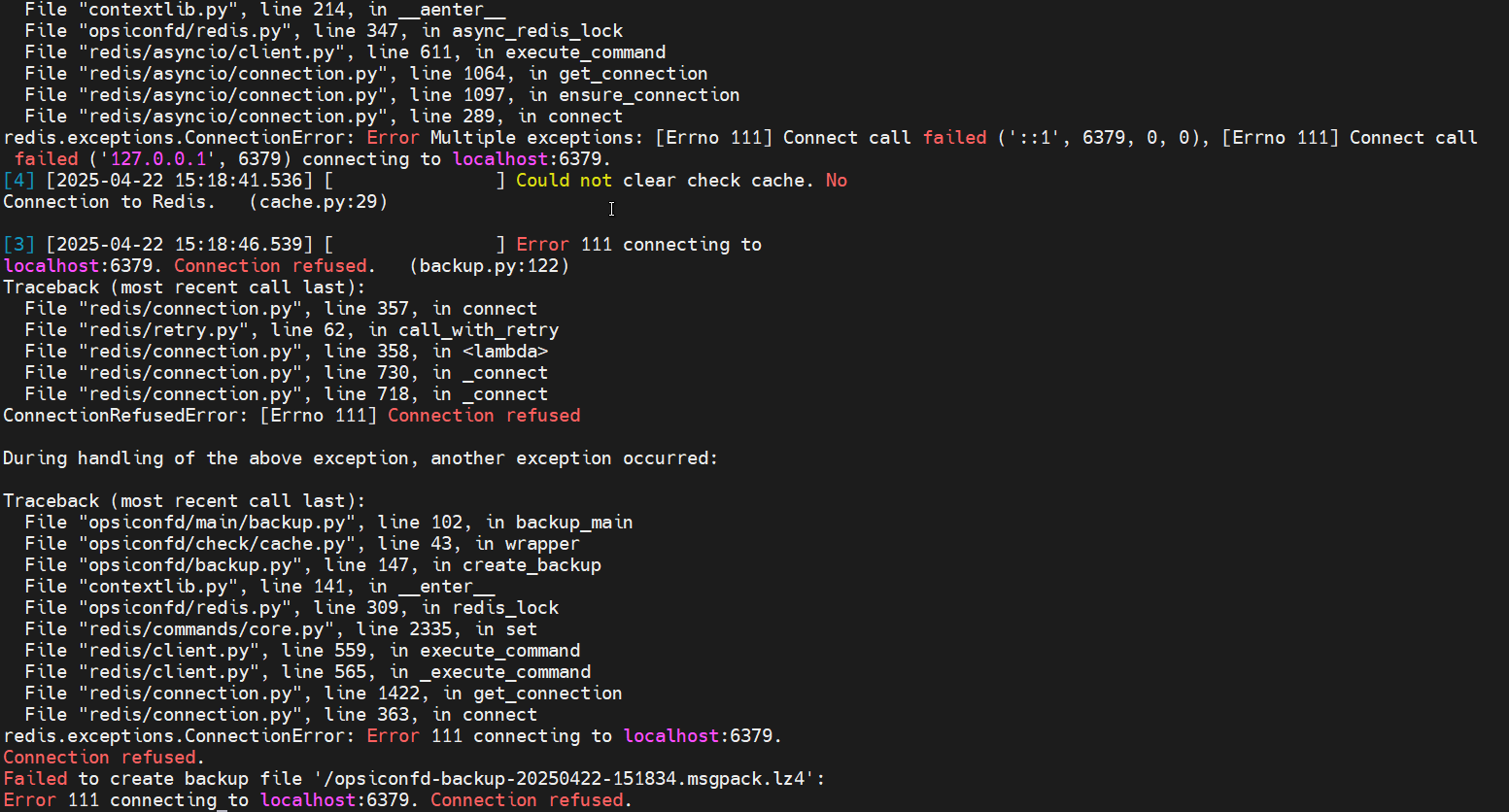

When running from the host:
When I try running the command from outside the container using:
docker exec opsi-server opsiconfd backup
I get the following error:
Multiple exceptions: [Errno 111] Connect call failed ('::1', 6379, 0, 0), [Errno 111] Connect call failed ('127.0.0.1', 6379)
Failed to create backup file '/opsiconfd-backup-20250422-145716.msgpack.lz4':
Error 111 connecting to localhost:6379. Connection refused.
root@ferrao-2025:/# docker exec opsi-server opsiconfd backupMultiple exceptions: [Errno 111] Connect call failed ('::1', 6379, 0, 0), [Errno 111] Connect call failed ('127.0.0.1', 6379)
It seems like opsiconfd is trying to connect to Redis, but the connection is refused.
