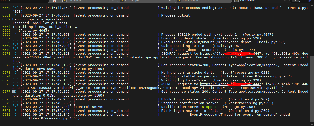

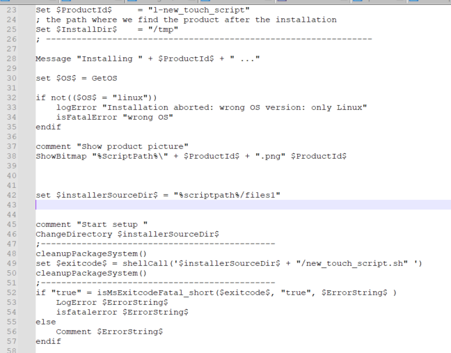

Thanks for the hints, tried a shell script to touch a file in /tmp directory with "shellCall()", did not get the result. Attached is the script and log image of opsiclientd.log. Where is the mistake?
Regards

Re: how to create a product that execute a given bash script for linux.
take a look into the opsi-script.log on the client in /var/log/opsi-script/
The shellcall is logged there and you can take a look if any errors occoured.
Regards

Hi Radtke
Thanks for your reply.
There is no error logged on opsi-script.log. Attached is a screenshot of the log on the previous post reply.
Regards,
arul
you can also download the package locally and start opsi-script locally to see where the script breaks. Exit Code is 1 so there's something wrong.
