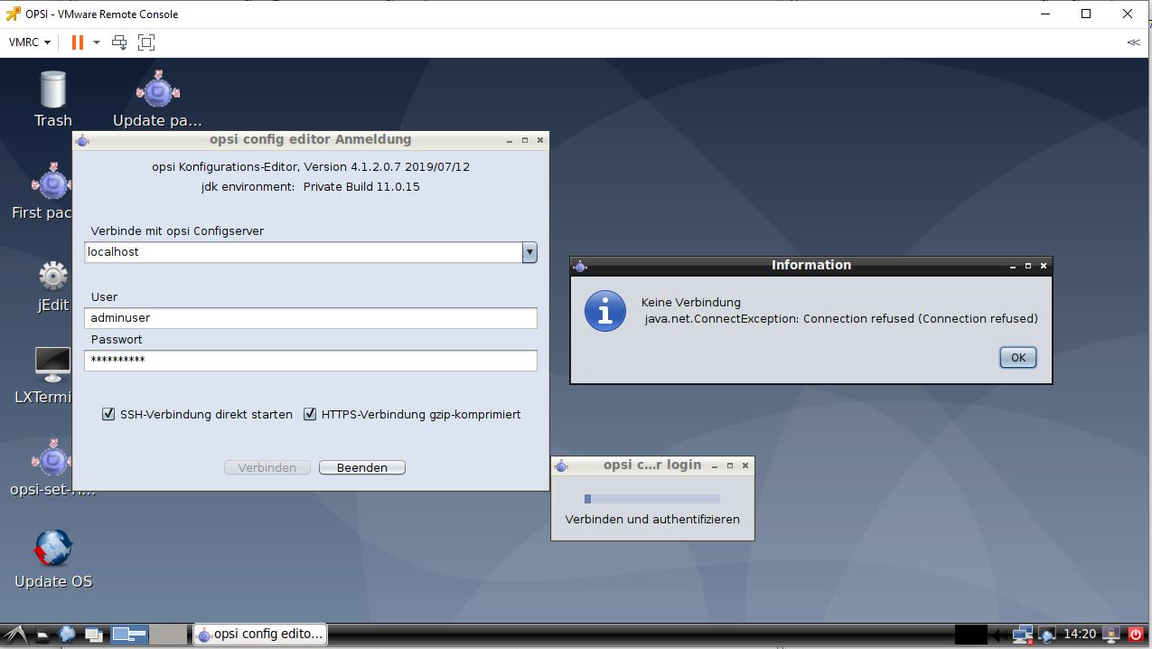

Error
Error
Hi, worked like a charm past 2 years. Made OS upgrade and updates and then it stopped letting in via https, server desktop (localhost) and client. Also new client installs stuck on same screen, attached a screenshot. Are there any commands to check and validate the current configuration or run a health-check/autofix to find problems? Opsi 4.1 in use i think.Thanks in advance!

Julez
Beiträge: 5
Registriert: 07 Sep 2020, 15:22
Re: Configed not working after upgrade (Ubuntu server 18-->20)
Beitrag von Julez »
wolfbardo hat geschrieben: 13 Jun 2022, 14:59 opsi 4.1 is not supported under Ubuntu 20.04
Please upgrade to opsi 4.2
https://download.uib.de/opsi4.2/documen ... tes-en.pdf
regards
bardo wolf
Hi and thanks for pointing right direction. At 4.3 in manual i get errors and missing command/services in current setup while trying to upgrage. Is there any way to check current configuration and maybe autorepair about all needed services etc?
I don't mind if the server needs to be reinstalled/configured, but current settings with software and client information must stay. 2 years from last configuration change so i remember just bits about configs in opsi:/
