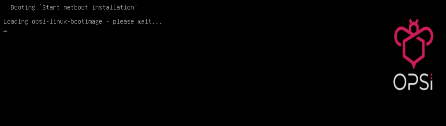

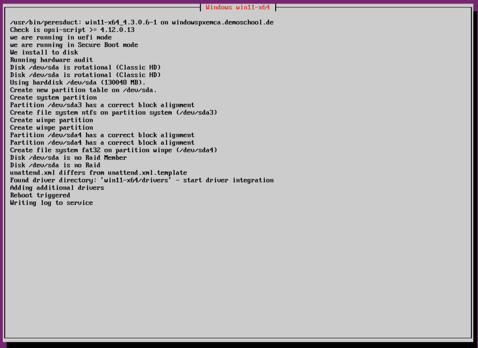

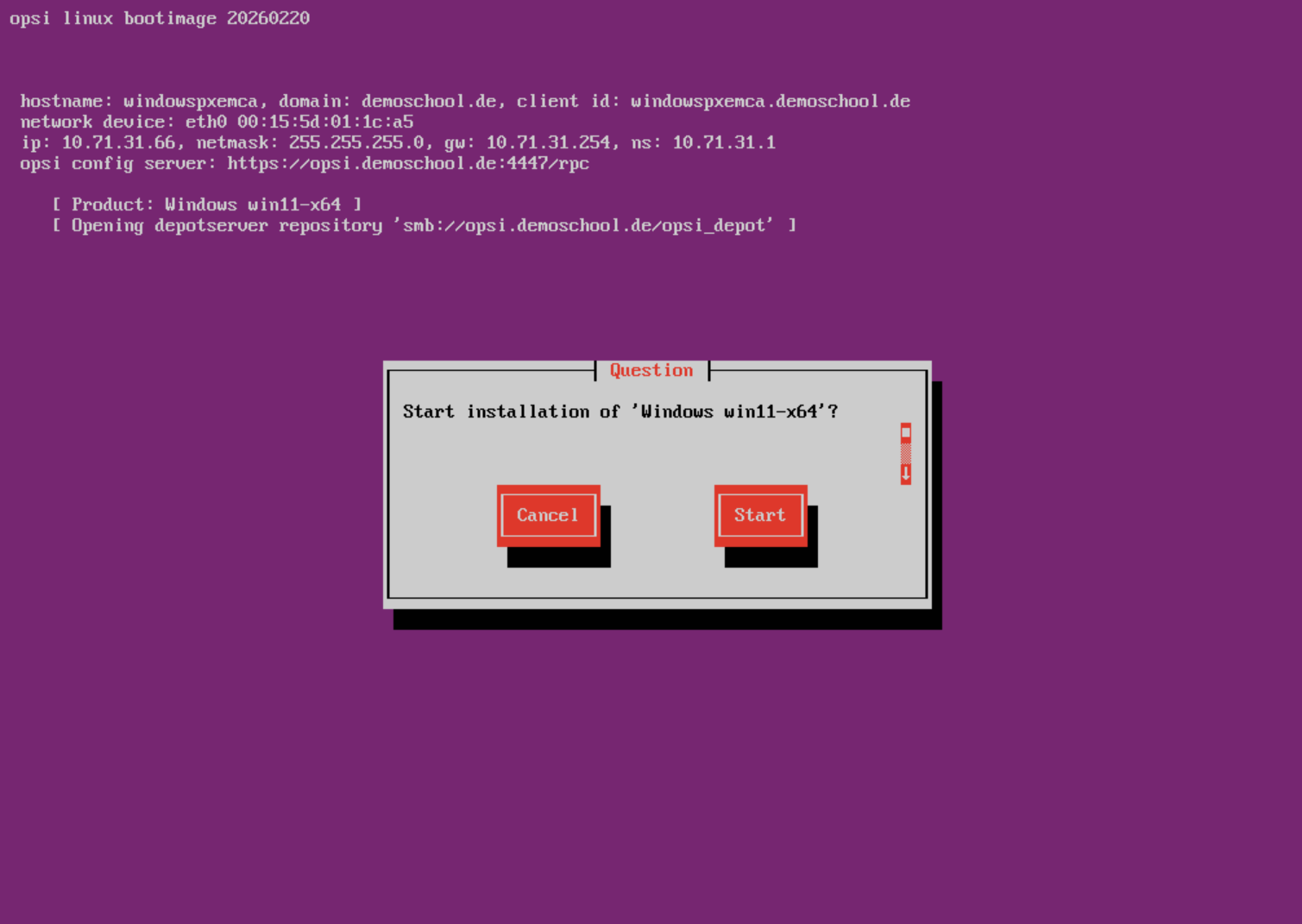

This is how the installation process looks like:
So it says, the installation was successful, but it wasn't, because when i reboot it starts booting over PXE again.

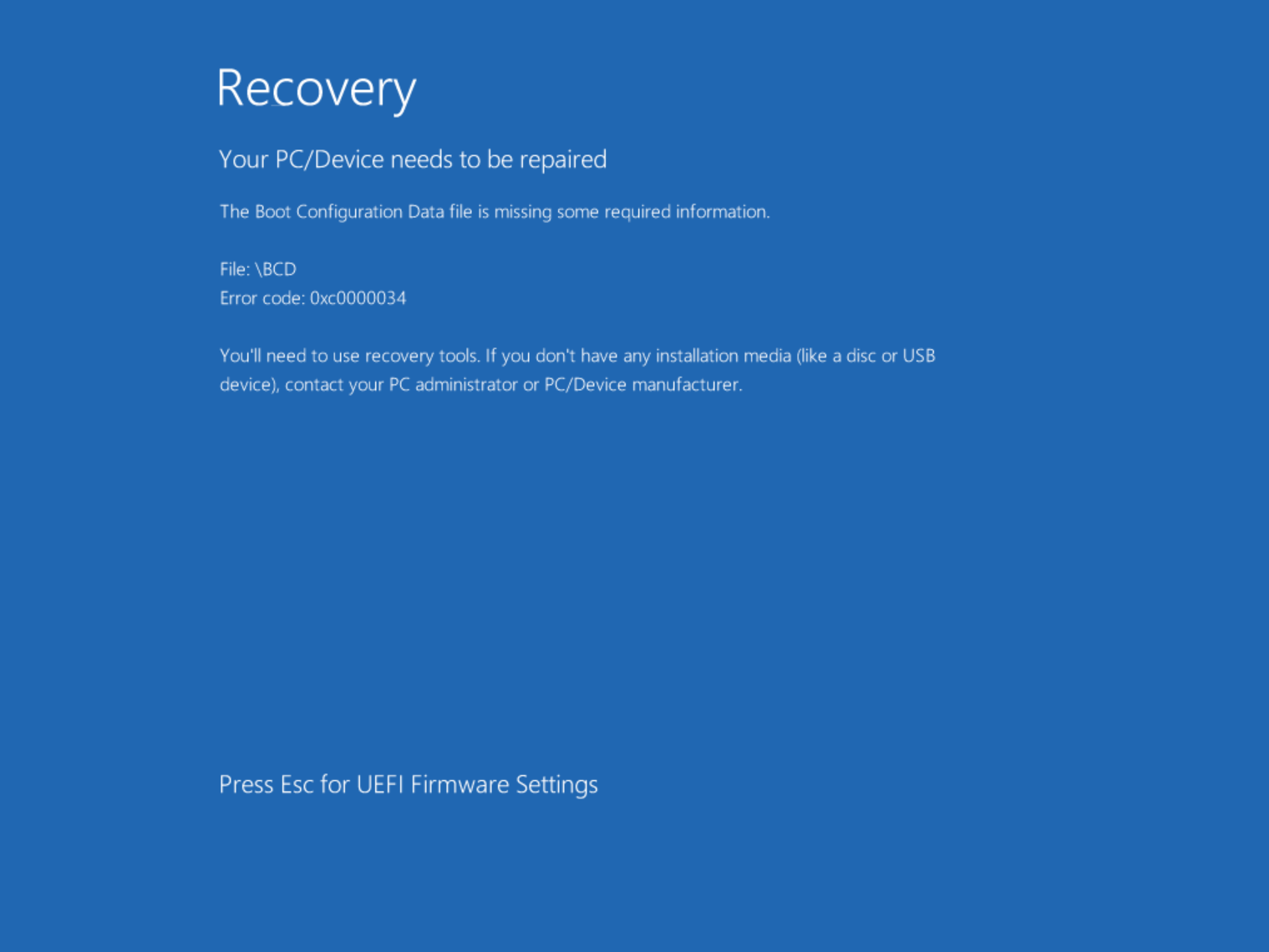

5. After rebooting again i get a Bluescreen
