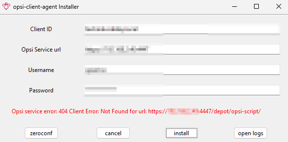

Beitrag von freddyD »
ich bekommen bei der Agent Installation egal ob über Helper oder MSI folgende Meldung:
404 not found /depot/opsi-script
[INFO      2026-03-06 10:41:06] Downloading '/depot/opsi-client-agent/opsi-meta-data.toml' to 'C:\Users\user~1\AppData\Local\Temp\oca-installation-helper-tmp\opsi-client-agent\opsi-meta-data.toml' (size: 256)   (opsiservice.py:1768)
[NOTICE    2026-03-06 10:41:06] Downloading product 'opsi-script' to 'C:\Users\user~1\AppData\Local\Temp\oca-installation-helper-tmp' from depot   (backend.py:168)
[ERROR     2026-03-06 10:41:06] Opsi service error: 404 Client Error: Not Found for url: https://IP:4447/depot/opsi-script/   (__main__.py:258)
  File "opsicommon\client\opsiservice.py", line 1335, in _request
  File "requests\models.py", line 1026, in raise_for_status
requests.exceptions.HTTPError: 404 Client Error: Not Found for url: https://IP:4447/depot/opsi-script/

scheinbar ist opsi-script auf dem Server nicht installiert.
Das Paket kann man beispielsweise über den opsi-package-updater installieren:
opsi-package-updater -v install opsi-script

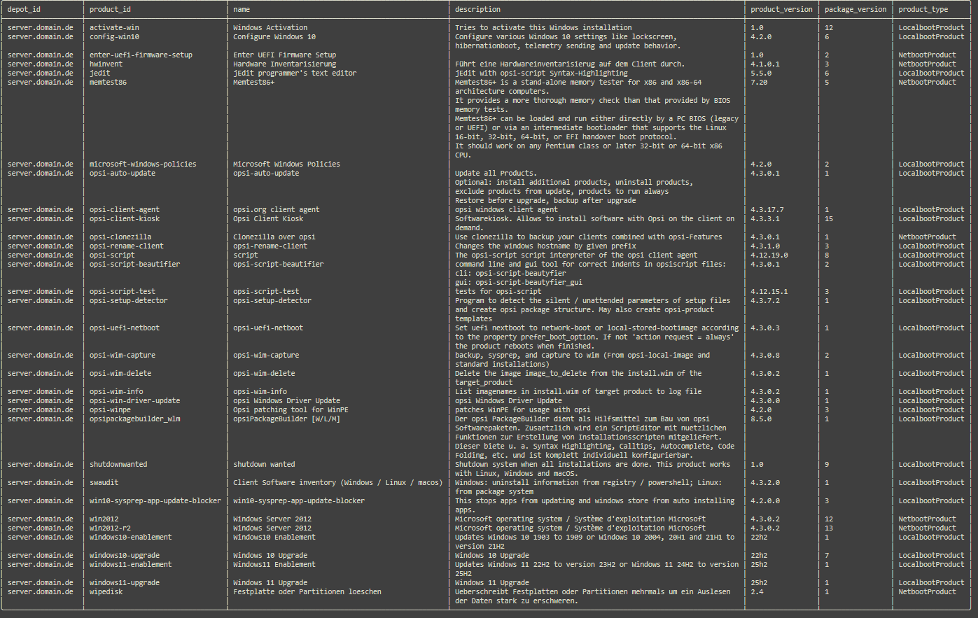

Ich hab es installiert:
opsi-package-updater -v install opsi-client-agent
[5] [2026-03-09 08:10:34.423] [               ] Repository metafile successfully                                         fetched: https://opsipackages.43.opsi.org/stable/packages.msgpack.zstd   (Updat                                        er.py:1288)
[5] [2026-03-09 08:10:34.653] [               ] No new packages available   (Upd                                        ater.py:294)

[1] [2026-03-09 08:10:46.663] [] ssl library path: C:\Users\user~1\AppData\Local\Temp\oca-installation-helper-tmp\opsi-script\windows\x86\libcrypto-3.dll
[1] [2026-03-09 08:10:46.663] [] Load library: C:\Users\user~1\AppData\Local\Temp\oca-installation-helper-tmp\opsi-script\windows\x86\libcrypto-3.dll
[1] [2026-03-09 08:10:46.664] [] Load library: C:\Users\user~1\AppData\Local\Temp\oca-installation-helper-tmp\opsi-script\windows\x86\libssl-3.dll
[1] [2026-03-09 08:10:46.664] [] OpenSSL version: OpenSSL 3.0.18 30 Sep 2025
[1] [2026-03-09 08:10:46.664] [] startmessage opsi-script created at CentralForm.FormCreate: 09.03.2026 08:10:46
[1] [2026-03-09 08:10:46.664] [] Detected Language is:
[1] [2026-03-09 08:10:46.664] [] Loading skin from: C:\Users\user~1\AppData\Local\Temp\oca-installation-helper-tmp\opsi-script\windows\x86\skin
[1] [2026-03-09 08:10:46.664] [] Called with parameter: C:\Users\user~1\AppData\Local\Temp\oca-installation-helper-tmp\opsi-client-agent\setup.opsiscript\r\nc:\opsi.org\log\opsi-client-agent.log\r\n/servicebatch\r\n/productid\r\nopsi-client-agent\r\n/opsiservice\r\nhttps://IP:4447\r\n/clientid\r\nserver.domain.de\r\n/username\r\nserver.domain.de\r\n/password\r\n***(confidential)***\r\n/parameter\r\nnoreboot
[1] [2026-03-09 08:10:46.664] [] Error: readconfig failed: Working with defaults 09.03.2026 08:10:46
[1] [2026-03-09 08:10:46.664] [] Depot path from readconfig:  p:\ 09.03.2026 08:10:46
[1] [2026-03-09 08:10:46.664] [] startmessage StartProgramModes and create log: 09.03.2026 08:10:46
[1] [2026-03-09 08:10:46.664] [] Compiled with FPC 3.2.2 for Win32-i386 at 17:43:38 on 2025/11/14
[1] [2026-03-09 08:10:46.664] [] program mode: pmBatch
[1] [2026-03-09 08:10:46.664] [] Cleanup old part files at 09.03.2026 08:10:46
[1] [2026-03-09 08:10:46.664] [] Prog: force_min_loglevel: 4
[1] [2026-03-09 08:10:46.664] [] Prog: default_loglevel: 7
[1] [2026-03-09 08:10:46.664] [] Prog: debug_prog: false
[1] [2026-03-09 08:10:46.664] [] Prog: debug_lib: true
[1] [2026-03-09 08:10:46.664] [opsi-client-agent] Prog: AktProduktId: opsi-client-agent = true
[6] [2026-03-09 08:10:46.664] [opsi-client-agent] Param: /productid: Got service credentials from parameters
[6] [2026-03-09 08:10:46.668] [opsi-client-agent] SSL lib (path) should be: C:\Users\user~1\AppData\Local\Temp\oca-installation-helper-tmp\opsi-script\windows\x86\libssl-3.dll
[7] [2026-03-09 08:10:46.672] [opsi-client-agent] SSL lib loaded: OpenSSL 3.0.18 30 Sep 2025
[7] [2026-03-09 08:10:46.672] [opsi-client-agent] Used Protocol: TLSv1.3
[6] [2026-03-09 08:10:46.705] [opsi-client-agent] HTTPSender Post succeeded
[6] [2026-03-09 08:10:46.705] [opsi-client-agent] Server-FQDN: IP Server-IP: IP
[6] [2026-03-09 08:10:46.706] [opsi-client-agent] JSON Bench for backend_getInterface "params":[],"id":1} Start: 08:10:46:672 Time: 00:00:00:034
[6] [2026-03-09 08:10:46.750] [opsi-client-agent] HTTPSender Post succeeded
[6] [2026-03-09 08:10:46.750] [opsi-client-agent] Server-FQDN: IP Server-IP: IP
[6] [2026-03-09 08:10:46.750] [opsi-client-agent] JSON Bench for backend_getLicensingInfo "params":[],"id":1} Start: 08:10:46:745 Time: 00:00:00:005
[6] [2026-03-09 08:10:46.755] [opsi-client-agent] HTTPSender Post succeeded
[6] [2026-03-09 08:10:46.755] [opsi-client-agent] Server-FQDN: IP Server-IP: IP
[6] [2026-03-09 08:10:46.755] [opsi-client-agent] JSON Bench for backend_info "params":[],"id":1} Start: 08:10:46:751 Time: 00:00:00:004
[6] [2026-03-09 08:10:46.761] [opsi-client-agent] HTTPSender Post succeeded
[6] [2026-03-09 08:10:46.761] [opsi-client-agent] Server-FQDN: IP Server-IP: IP
[6] [2026-03-09 08:10:46.762] [opsi-client-agent] JSON Bench for getDepotId "params":["server.domain.de"],"id":1} Start: 08:10:46:755 Time: 00:00:00:007
[3] [2026-03-09 08:10:46.762] [opsi-client-agent] Error: retrieveJSONObject --- opsi service problem ----> {"message":"list index out of range","details":null,"class":"IndexError"}
[3] [2026-03-09 08:10:46.762] [opsi-client-agent] Received (first 512): {"id":1,"error":{"message":"list index out of range","class":"IndexError","details":null},"result":null}
[6] [2026-03-09 08:10:46.771] [opsi-client-agent] HTTPSender Post succeeded
[6] [2026-03-09 08:10:46.771] [opsi-client-agent] Server-FQDN: IP Server-IP: IP
[6] [2026-03-09 08:10:46.772] [opsi-client-agent] JSON Bench for backend_getInterface "params":[],"id":1} Start: 08:10:46:762 Time: 00:00:00:010
[6] [2026-03-09 08:10:46.823] [opsi-client-agent] HTTPSender Post succeeded
[6] [2026-03-09 08:10:46.823] [opsi-client-agent] Server-FQDN: IP Server-IP: IP
[6] [2026-03-09 08:10:46.823] [opsi-client-agent] JSON Bench for productPropertyState_getValues "params":["opsi-client-agent","","server.domain.l Start: 08:10:46:813 Time: 00:00:00:010
[7] [2026-03-09 08:10:46.823] [opsi-client-agent] Got ProductProperty state values
[7] [2026-03-09 08:10:46.823] [opsi-client-agent] InitProduct
[6] [2026-03-09 08:10:46.828] [opsi-client-agent] HTTPSender Post succeeded
[6] [2026-03-09 08:10:46.828] [opsi-client-agent] Server-FQDN: IP Server-IP: IP
[6] [2026-03-09 08:10:46.828] [opsi-client-agent] JSON Bench for getProduct_hash "params":["opsi-client-agent","-> {"],"id":1} Start: 08:10:46:823 Time: 00:00:00:005
[3] [2026-03-09 08:10:46.828] [opsi-client-agent] Error: retrieveJSONObject --- opsi service problem ----> {"message":"Backend missing data error: No product with id 'opsi-client-agent' on depot '-> {' found","details":null,"class":"BackendMissingDataError"}
[3] [2026-03-09 08:10:46.828] [opsi-client-agent] Received (first 512): {"id":1,"error":{"message":"Backend missing data error: No product with id 'opsi-client-agent' on depot '-> {' found","class":"BackendMissingDataError","details":null},"result":null}
[4] [2026-03-09 08:10:46.828] [opsi-client-agent] Error: Opsi4Data.initProduct: getProduct_hash failed: retry
[6] [2026-03-09 08:10:47.338] [opsi-client-agent] HTTPSender Post succeeded
[6] [2026-03-09 08:10:47.338] [opsi-client-agent] Server-FQDN: IP Server-IP: IP
[6] [2026-03-09 08:10:47.338] [opsi-client-agent] JSON Bench for getProduct_hash "params":["opsi-client-agent","-> {"],"id":1} Start: 08:10:47:330 Time: 00:00:00:008
[3] [2026-03-09 08:10:47.338] [opsi-client-agent] Error: retrieveJSONObject --- opsi service problem ----> {"message":"Backend missing data error: No product with id 'opsi-client-agent' on depot '-> {' found","details":null,"class":"BackendMissingDataError"}
[3] [2026-03-09 08:10:47.338] [opsi-client-agent] Received (first 512): {"id":1,"error":{"message":"Backend missing data error: No product with id 'opsi-client-agent' on depot '-> {' found","class":"BackendMissingDataError","details":null},"result":null}
[3] [2026-03-09 08:10:47.338] [opsi-client-agent] Opsi4Data.initProduct: getProduct_hash failed: giving up
[3] [2026-03-09 08:10:47.338] [opsi-client-agent] no product_hash found for client: -> {"message":"list index out of range","details":null,"class":"IndexError"} and product: opsi-client-agent
[2] [2026-03-09 08:10:47.338] [opsi-client-agent] Could not connect to Service !
[6] [2026-03-09 08:10:47.343] [opsi-client-agent] HTTPSender Post succeeded
[6] [2026-03-09 08:10:47.343] [opsi-client-agent] Server-FQDN: IP Server-IP: IP
[6] [2026-03-09 08:10:47.344] [opsi-client-agent] JSON Bench for backend_info "params":[],"id":1} Start: 08:10:47:339 Time: 00:00:00:005
[6] [2026-03-09 08:10:47.353] [opsi-client-agent] HTTPSender Post succeeded
[6] [2026-03-09 08:10:47.353] [opsi-client-agent] Server-FQDN: IP Server-IP: IP
[6] [2026-03-09 08:10:47.354] [opsi-client-agent] JSON Bench for backend_getInterface "params":[],"id":1} Start: 08:10:47:344 Time: 00:00:00:010
[6] [2026-03-09 08:10:47.403] [opsi-client-agent] HTTPSender Post succeeded
[6] [2026-03-09 08:10:47.403] [opsi-client-agent] Server-FQDN: IP Server-IP: IP
[6] [2026-03-09 08:10:47.403] [opsi-client-agent] JSON Bench for configState_getValues "params":[["opsi-script.global.debug_prog","opsi-s Start: 08:10:47:392 Time: 00:00:00:011
[1] [2026-03-09 08:10:47.404] [opsi-client-agent] readConfigFromService: ok
[1] [2026-03-09 08:10:47.404] [opsi-client-agent] serviceBatch force_min_loglevel: 0
[1] [2026-03-09 08:10:47.404] [opsi-client-agent] serviceBatch default_loglevel: 7
[1] [2026-03-09 08:10:47.404] [opsi-client-agent] serviceBatch debug_prog: false
[1] [2026-03-09 08:10:47.404] [opsi-client-agent] serviceBatch debug_lib: false
[7] [2026-03-09 08:10:47.404] [opsi-client-agent] serviceBatch: update switches .....
[3] [2026-03-09 08:10:47.404] [opsi-client-agent] exception in opsi4data.UpdateSwitchest  Access violation
[3] [2026-03-09 08:10:47.404] [opsi-client-agent] Error in opsi4data.UpdateSwitches, Actionstr:
[1] [2026-03-09 08:10:47.404] [] ============  opsi-script Version 4.12.19.0 is regularly exiting. Time 2026-03-09  08:10:47 Exitcode: 0 .

leider habe ich nach wie vor Probleme bei der Client Agent Installation. Ist aus den zu vor gelisteten Log herauszulesen an was es liegen könnte?
Ich würde mich über eine Rückmeldung freuen!

Was ist die Ausgabe von:
opsi-cli package list
freddyD
Beiträge: 7
Registriert: 06 Mär 2026, 11:24
Re: Client Agent Install Windows - 404 not found /depot/opsi-script
Für die Übersichtlichkeit hab ich mal einen Screenshot angefügt, da das Textfeld leider die Formatierung ändert.
Hier die Spalte "product_id"
product_id
activate-win
config-win10
enter-uefi-firmware-setup
hwinvent
jedit
memtest86
microsoft-windows-policies
opsi-auto-update
opsi-client-agent
opsi-client-kiosk
opsi-clonezilla
opsi-rename-client
opsi-script
opsi-script-beautifier
opsi-script-test
opsi-setup-detector
opsi-uefi-netboot
opsi-wim-capture
opsi-wim-delete
opsi-wim-info
opsi-win-driver-update
opsi-winpe
opsipackagebuilder_wlm
shutdownwanted
swaudit
win10-sysprep-app-update-blocker
win2012
win2012-r2
windows10-enablement
windows10-upgrade
windows11-enablement
windows11-upgrade
wipedisk
2026-03-12 07_15_32-_new 3 - Notepad++.png (143.82 KiB) 101018 mal betrachtet
