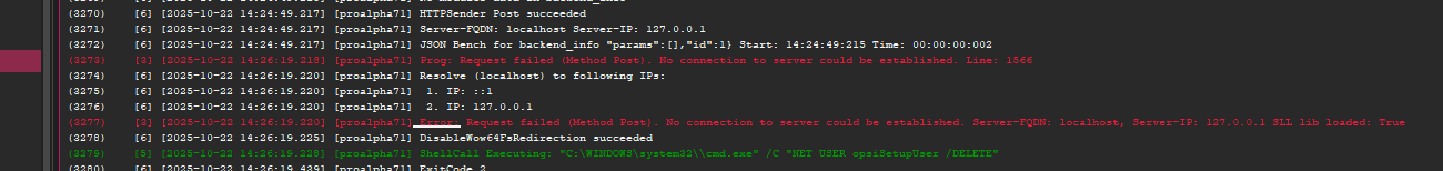

ich habe mittels opsi-setup-detector ein Paket (with user login) erstellt.
Ich Starte das Script mit dem Parameter: execution_method = loginOpsiSetupUser
Das Script installiert alle gewünschten Programme korrekt, jedoch erscheint als Status im opsi-configed trotzdem "unknown - failed(setup)
Im opsiscriptlog erscheint der Fehler im Stage 4 Bereich - Sub_Delete_OpsiSetupUser
Error: Request failed (Method Post). No connection to server could be established. Server-FQDN: localhost, Server-IP: 127.0.0.1 SLL lib loaded: True
[6] [2025-10-17 11:42:16.393] [opsipaket] ~~~~~~~ Start Sub ~~~~~~~ Sub_Delete_OpsiSetupUser
[5] [2025-10-17 11:42:16.393] [opsipaket] comment: Removing the opsiSetupUser if present
[5] [2025-10-17 11:42:16.393] [opsipaket] Execution of: opsiServiceCall_removeOpsiSetupUser /opsiclientd-once
[6] [2025-10-17 11:42:16.393] [opsipaket] "method": "removeOpsiSetupUser"
[6] [2025-10-17 11:42:16.397] [opsipaket] SSL lib (path) should be: C:\Program Files (x86)\opsi.org\opsi-client-agent\opsi-script\libssl-3.dll
[7] [2025-10-17 11:42:16.397] [opsipaket] SSL lib loaded: OpenSSL 3.0.17 1 Jul 2025
[7] [2025-10-17 11:42:16.397] [opsipaket] Used Protocol: TLSv1.3
[6] [2025-10-17 11:42:16.442] [opsipaket] HTTPSender Post succeeded
[6] [2025-10-17 11:42:16.442] [opsipaket] Server-FQDN: localhost Server-IP: 127.0.0.1
[6] [2025-10-17 11:42:16.442] [opsipaket] JSON Bench for backend_getInterface "params":[],"id":1} Start: 11:42:16:397 Time: 00:00:00:045
[6] [2025-10-17 11:42:16.448] [opsipaket] No method backend_getLicensingInfo at service - perhaps old server or opsiclientd, we fallback to backend_info
[6] [2025-10-17 11:42:16.452] [opsipaket] HTTPSender Post succeeded
[6] [2025-10-17 11:42:16.452] [opsipaket] Server-FQDN: localhost Server-IP: 127.0.0.1
[6] [2025-10-17 11:42:16.452] [opsipaket] JSON Bench for backend_info "params":[],"id":1} Start: 11:42:16:448 Time: 00:00:00:004
[6] [2025-10-17 11:42:16.452] [opsipaket] No modules data in backend_info
[6] [2025-10-17 11:42:16.455] [opsipaket] HTTPSender Post succeeded
[6] [2025-10-17 11:42:16.455] [opsipaket] Server-FQDN: localhost Server-IP: 127.0.0.1
[6] [2025-10-17 11:42:16.455] [opsipaket] JSON Bench for backend_info "params":[],"id":1} Start: 11:42:16:452 Time: 00:00:00:003
[3] [2025-10-17 11:43:46.455] [opsipaket] Prog: Request failed (Method Post). No connection to server could be established. Line: 1566
[6] [2025-10-17 11:43:46.456] [opsipaket] Resolve (localhost) to following IPs:
[6] [2025-10-17 11:43:46.456] [opsipaket] 1. IP: ::1
[6] [2025-10-17 11:43:46.456] [opsipaket] 2. IP: 127.0.0.1
[3] [2025-10-17 11:43:46.456] [opsipaket] Error: Request failed (Method Post). No connection to server could be established. Server-FQDN: localhost, Server-IP: 127.0.0.1 SLL lib loaded: True
[6] [2025-10-17 11:43:46.462] [opsipaket] DisableWow64FsRedirection succeeded
[5] [2025-10-17 11:43:46.464] [opsipaket] ShellCall Executing: "C:\WINDOWS\system32\\cmd.exe" /C "NET USER opsiSetupUser /DELETE"
[6] [2025-10-17 11:43:46.692] [opsipaket] ExitCode 2
[7] [2025-10-17 11:43:46.692] [opsipaket] output:
[7] [2025-10-17 11:43:46.692] [opsipaket] --------------
[7] [2025-10-17 11:43:46.692] [opsipaket] Der Benutzername konnte nicht gefunden werden.
[7] [2025-10-17 11:43:46.692] [opsipaket] Sie erhalten weitere Hilfe, wenn Sie NET HELPMSG 2221 eingeben.
[6] [2025-10-17 11:43:46.692] [opsipaket] RevertWow64FsRedirection succeeded
[6] [2025-10-17 11:43:46.698] [opsipaket] The value of the variable "$ExitCode$" is now: "2"

so ich hab's nun doch geschafft, den openedge Client mit dem script opsi-template-with-user zu installieren.
Wie schon im 1. Post geschrieben, wird das Programm korrekt installiert, nur beim "Aufräumen" wirft das Script einen Fehler und stellt den Paketstatus im opsi-configed auf "failed(setup)"
Setup with user login1.png (18.83 KiB) 2958 mal betrachtet
