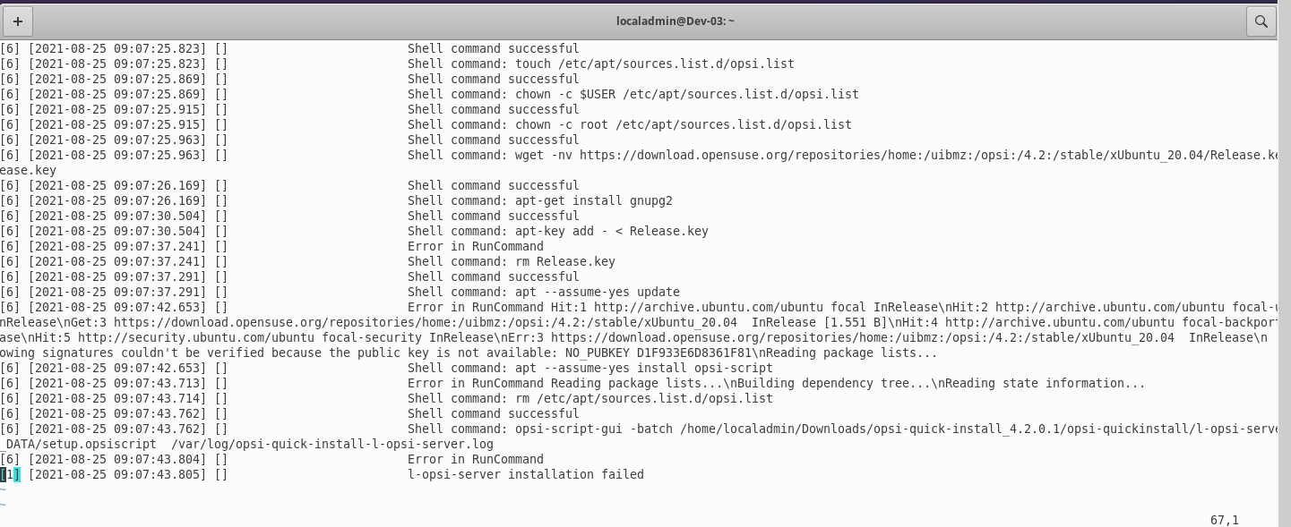

i want to ask about opsi server install
i install it of ubuntu 20 and after i started the quickinstall
i had this error
can anyone helb me
thanks

- 2021-08-25_09h10_01.png (118.05 KiB) 7722 mal betrachtet

lately there occurred a problem with "apt-key add - < Release.key" sometimes, so please try the following:
1. Add the key manually: Open a terminal in /opsi-quickinstall/gui/ and execute
and then
without the " - < " between "add" and "Release.key" !
2. Try opsi QuickInstall again.
I hope it will help : )
Regards
Anja
sudo wget -nv https://download.opensuse.org/repositories/home:/uibmz:/opsi:/4.2:/stable/xUbuntu_20.04/Release.key -O Release.key Code: Alles auswählen
sudo apt-key add Release.key 2. Try opsi QuickInstall again.
Regards
Anja

to give an update: Since Opsi-QuickInstall version 4.2.0.1-2 this bug is fixed.
Regards
Anja
