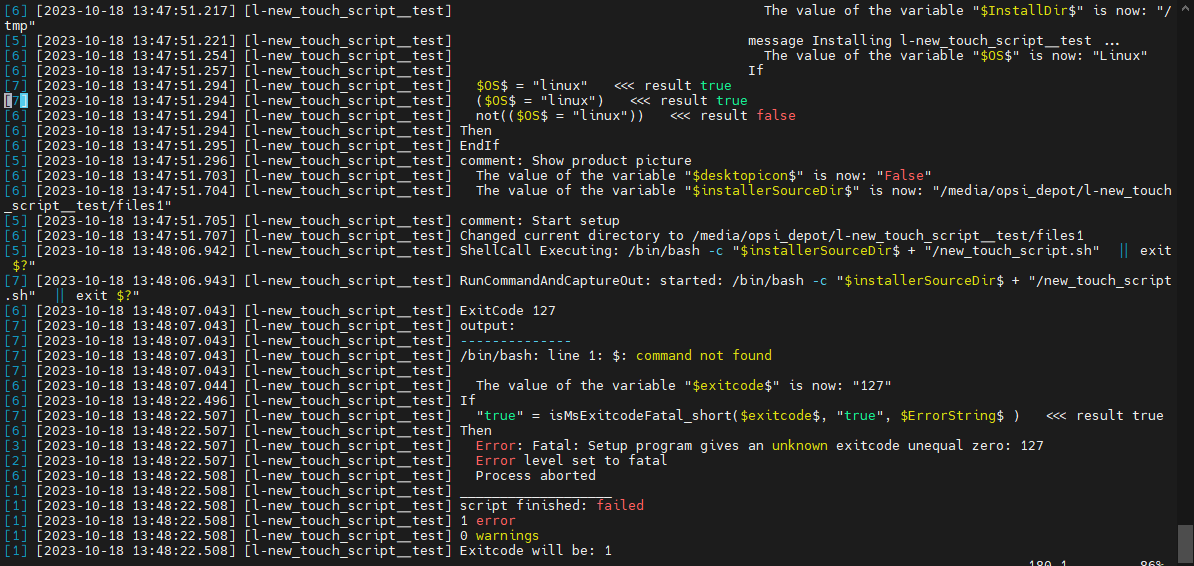

Sorry for making late attempt. I tried again and analyzed it. The attached log image says, " /bin/bash: line 1: $: command not found" but "/bin/bash" exists.
As per log, the following is the place it breaks with exit code 127:
"/bin/bash -c "$installerSourceDir$ + "/new_touch_script.sh" || exit $?""
The following worked fine on the terminal:
"/bin/bash -c /tmp/new_touch_script.sh" || exit $?" (this working fine)
As you suggested, tried the package locally with opsi-script, and it breaks in the same place mentioned above.

Re: how to create a product that execute a given bash script for linux.
this should work
set $exitcode$ = shellCall($installerSourceDir$ + "/new_touch_script.sh")
theres a difference how to use opsi-script variables in primary and secondary sections. Primary sections like this you dont include the variable within the string of the command, in secondary sections, like shellInAnIcon, you do.
Regards

Thanks Mathias,
It worked fine on local. Did the correction on opsi-server also, but from opsi-server getting same error. Attaching log image.
While i tried running from server, noticed it gets mounted for short time on "/media/opsi_depot/" with root permission, is it normal?

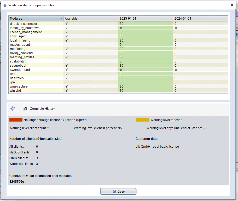

Hi Mathias,
Have very few hosts installed and installed the license around 2nd week of September. Attached is an image of validation. Hope it is not for validity issues.
Regards,
arul
soooo
it works with
set $exitcode$ = shellCall($installerSourceDir$ + '/new_touch_script.sh')
As the opsi-script interpreter uses double quotes arround the shellCall itself while interpreting, you have to use single quotes for the string part of the shellCall
