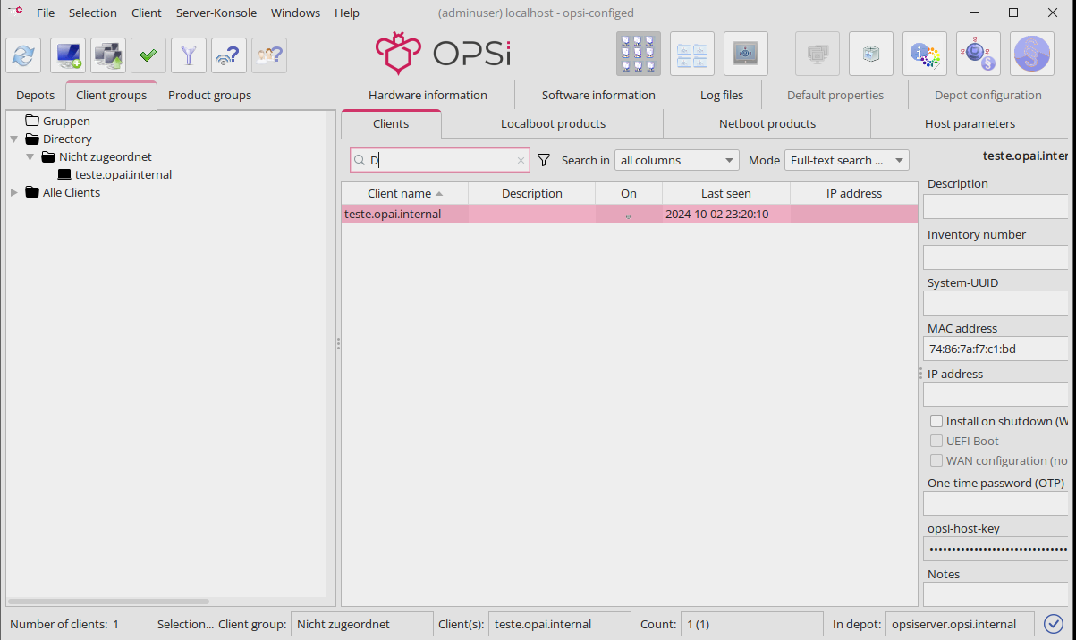

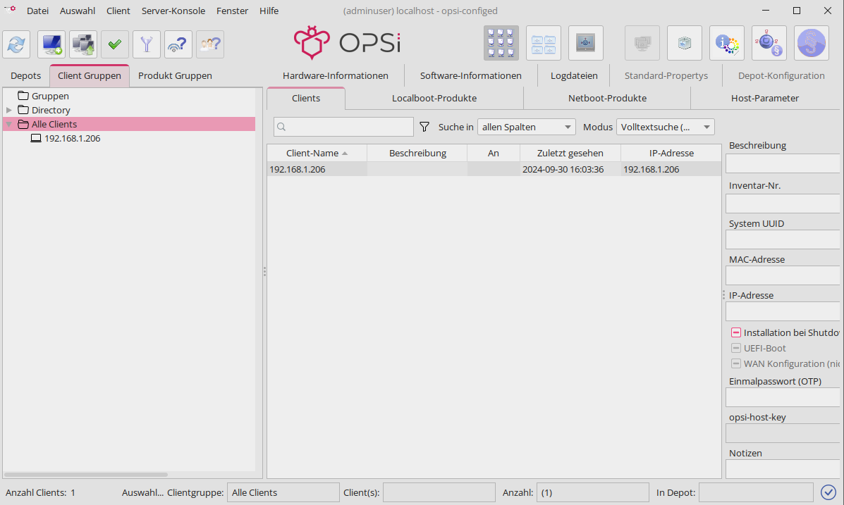

I'm having trouble implementing opsi at my work. I downloaded opsi on my VM (virtual machine) and followed the documentation step by step, the "Quick Start" section. After that, I installed the client on the client's (employee's) computer and configured it on the client's machine. However, when I go to implement the product, it doesn't install. I need help with the implementation. If anyone can help me, I'd be grateful.
Screenshots of my screens in opsiconfiged
NOTE: In my opsi-configed, my client doesn't appear as 'ON'.
I can send the opsiconfd logs if necessary.

Hello!
How did you install the opsi-client-agent on the machine?
Please do not use an IP-address as the ID for the client.
Please reinstall the opsi-client-agent on the computer using the opsi-client-agent-installer (you can find it in https://<your-opsi-server>:4447/public/opsi-client-agent/).
On the dialog asking for the Client-ID fill in the FQDN of the computer: <hostname>.<dns-domain>
For example: client1.scalco.local
Use your admin credentials for username and password and click on "install".

Before this test, I entered the ID during the installation, and followed the step-by-step instructions for entering the FQDN. When I followed these steps, the installation went well, but I still got the error that "ON" did not appear on the client and I was unable to install the product on the machines via the server.
On the client's computer, there was no DNS domain, so I logged into the network and entered a "DNS suffix for this network". Can this be used as a "DNS domain"?
NOTE: I may be sending a screenshot when doing these installation tests with the FQDN

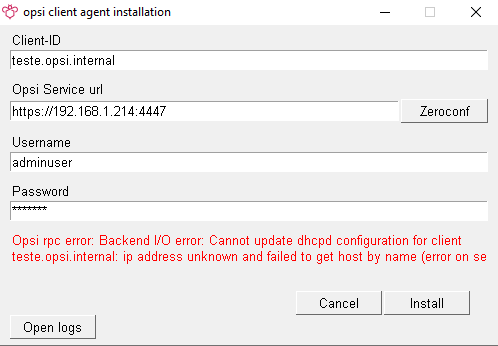

I tried following the step-by-step instructions you provided, but it didn't work. I downloaded the server again, configured the products on the server, but when I tried to install the client on the client PC, I initially got this error:
64a5a701-d611-4ba8-826f-0e7b2dbe179d__Captura de tela 2024-10-02 164035.png (4.95 KiB) 2530 mal betrachtet
However, when I manually enter the address of my server or search for it, the installation succeeds and the installer starts. On the server and client, it looks like this:
Captura de tela 2024-10-02 170207.png (99.88 KiB) 2530 mal betrachtet
I still can't install the products on my client. I've checked the logs, but I don't understand them very well.

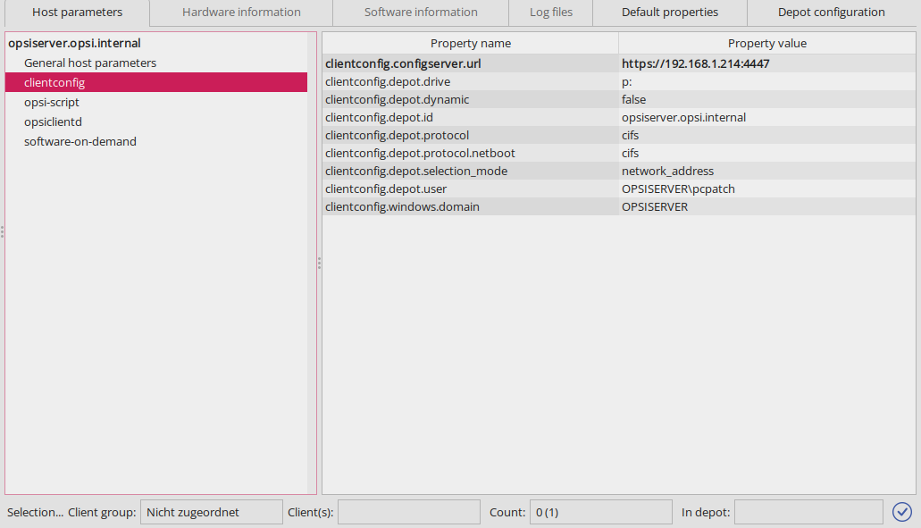

Beiträge: 2042
Re: Installing glpi/config/client
The name of the opsi server "opsiserver.opsi.internal" cannot be resolved.
You can add the name to your DNS server or you can use an IP address to connect to the opsi server.
If you want to use an IP address, click on the "server configuration" button in opsi-configed and change the value of "clientconfig.configserver.url" to "https://192.168.1.214:4447".
Then install the opsi-client-agent again.

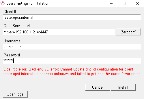

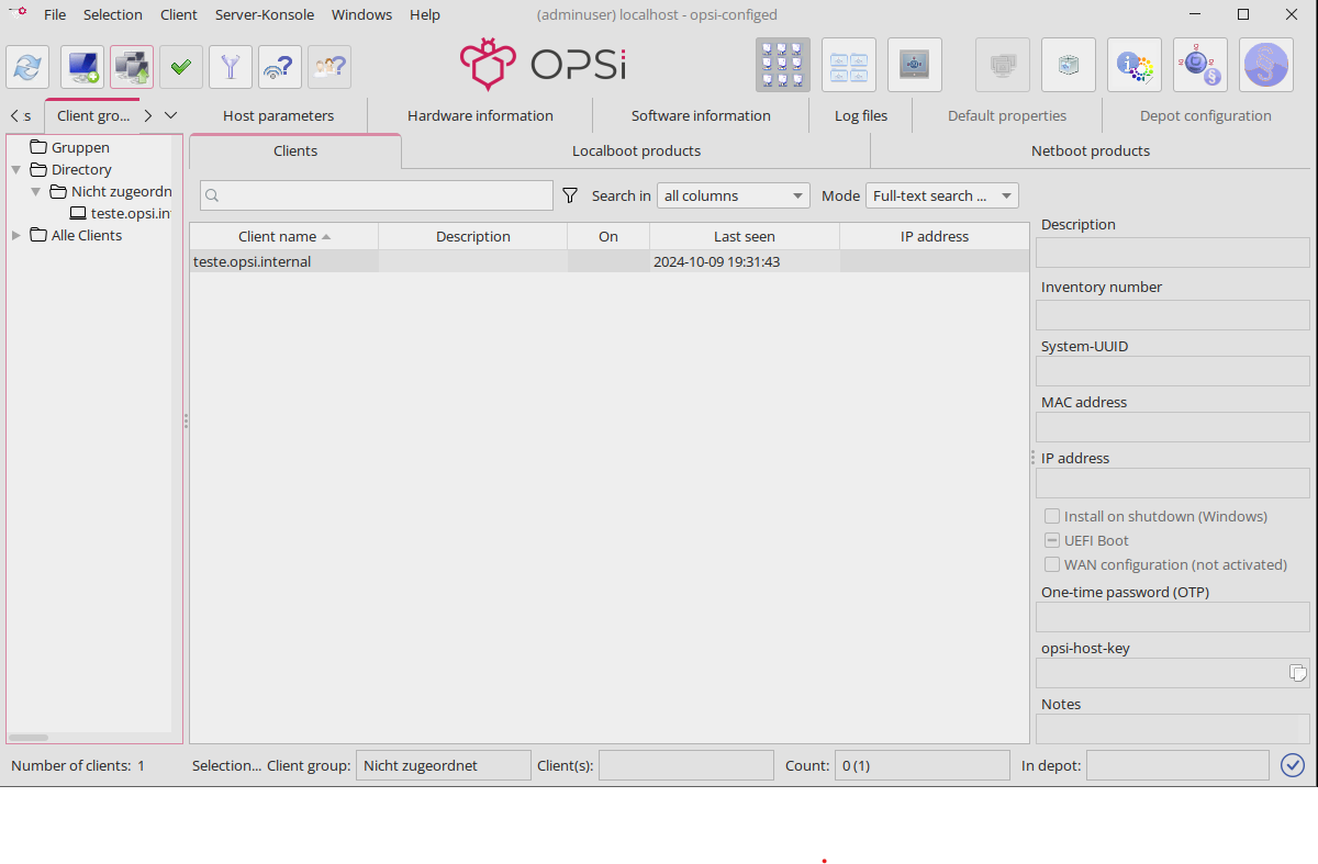

I performed the configuration as you described, but when I tried to install the client again on the machine, the following error occurred on the client:
The client appears on the server, but the ON part is not set
Beiträge: 2042
Please deactivate the DHCP-Backend.
Edit the file /etc/opsi/backends/dhcpd.conf on the opsi config server and set
"enabled": False,
Restart opsiconfd after the change:
systemctl restart opsiconfd
Then reinstall opsi-client-agent on the device.
See the documentation for details: https://docs.opsi.org/opsi-docs-en/4.3/ ... r-autoconf
